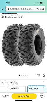

Hey guys new to the group but long story short we have rebuilt my old thunder kart pics are attached. My son is wanting to add larger tires to this kart for off road use and I am wondering what size tires should I get the original tires on this kart are :
Front 4.10/3.50-4
Rear 13x5x6
the wheels or rims on it connect through the tire and bolt. So it’s not like a single rim. Would the Amazon tires attached work for the rear? If they do what size should I go with for the fronts keep in mind the fronts are 4’s not 6’s

Unfortunately with using a centrifugal clutch you can not. Without significant rework to the rear of the kart you are limited to the smaller sized tires.

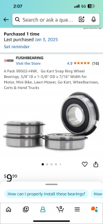

For bearings, they are usually just a press-fit into the hubs. You may not need the type you showed us, as that black ring is designed to prevent it from going too deep into the hub but they will still work. Usually a go kart hub has an inner ledge where the bearing is seated flush against. If your hubs lack this "ledge" then the rings are necessary.
Be aware that most bearings like these can be repacked. If the ones you have now are noisy, you can pry the rubber seal out carefully (don't damage it) and slather some bearing grease in there and reassemble. It should work well unless the bearings are rusty, pitted and too far gone. Most people think they are disposable, but they can be maintained.
Denny is right. With monster tires, you will just burn out the clutch because they will be too big for the gear ratio. You will finally need a TAV / Torq-A-Verter. But a clutch and some road tires are fine for pavement.
The ideal gear ratio for a 13″ tire is 6:1, (Gear ratio = teeth in axle sprocket / teeth in the clutch sprocket), if you want larger tires then you’ll need to decrease the ratio accordingly but it will affect your speed. You should read this thread:
