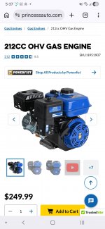

I have a Powerfist 6.5 212cc 4 stroke nonhemi (it's a pred/Honda clone), sitting in the box in the shop already.

Your frame ( the kart in general ) needs quite a bit of work. But for free it's really pretty good. The list of goodies for the engine is right on. When you open it up, remove the low oil sensor and the COMPLETE governor mechanism. That's why you put in the billet rod and flywheel. 22 or 26 lb. springs would be better. Unless your rear tires are
22" to 25" tall, a 72 tooth axle sprocket is too big. Not only for ground clearance, but you'll be too low geared. A 60 tooth with 18" to 20" tires (driven by a 10 tooth ) is the gold standard. Good acceleration and hill climbing ability, and good top speed.

Are you saying that the Canadian Powerfist 212 comes with a lighting coil/alternator? Man, that's nice.
The only way the same setup makes sense is on a lawn tractor where you’re mowing full throttle and the lights are as bright as they can get.
No, only assuming he was planning to add one since he was talking about electronics. I guess he could be planning to charge a yuge battery to use.
Oh wait he mentioned the flywheel.
Oh well. I missed that whole part!
