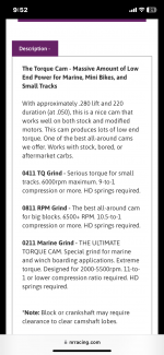

Remind me. The 0811 means 108 Intake Center line and 111 lobe separation angle?
NR has this listed as the RPM version of this cam. 10.5 : 1 Static Compression Ratio is the Minimum Recommended. Static Compression is only kinda useful. Dynamic Compression Ratio is what matters. Not only the volume sweep of the piston, but the timing of the valves determines the dynamic compression ratio.
Russel at NR does a good job of describing which static CR works best with his camshafts.
Long story short, I wouldn’t be too worried about the octane with the 108 ICL. The 102 needs 11:1 or Lower. The 108 likes higher CR’sIMG_7846.png
