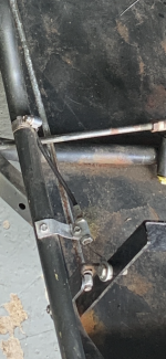

Attaching pic showing a shiny chrome very strong spring I added to pull my linkage forward (returns gas pedal to zero). Everyone should have a spring like that added on somewhere!
