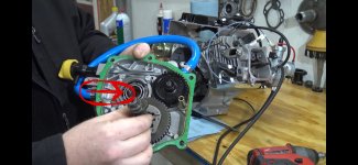

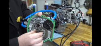

anyway… always thought this DTV Shredder Engine with oil pump was cool. This one supposedly does feed the rod bearing.

If you're dead set on feeding more oil to the rockers there is a very simple way to do it. Buy a ARC billet side cover (it's already got 2 , 1/8" npt ports in it). Then buy one of the many available thick aluminum valve covers. They usually come with 2 or 3 threaded ports in them. Same thread as the side cover. Run a hose from the side cover to the valve cover, and another from the valve cover to a catch can. Your rocker assembly will be swimming in oil. Both pieces are quite expensive $150 side cover. $40 to $60 valve cover. If you are skilled enough, for the price of a tap and drill bit, $15 max , you can thread the stock parts and achieve the same thing. The pictures in post #7 show something very similar, except I think it's powering a fuel pump. What you're proposing ( oiling the top end ) is done all the time.
