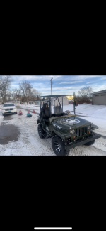

Chinese PAZ200 mini Jeep project.
I bought this from china, showed up in a crate.
I love the thing but they put a wee lol 175cc gy6 in it. (It’s sold claiming to have 200cc, but no, it’s very much 175cc.)
The result is a fun lil unit, at WOT maybe 28mph at 7k rpm’s. (Loud and rattly)
so I’ve been contemplating this for some time, swapping in a bigger, manual transmission motor with an auto clutch. The goal here is enough power to spin the tires in snow, and a top speed of hopefully 35-40 so it’s not screaming like a banshee driving around town.
I bought a 1987 Honda trx350 that has everything I need, but it’s a 4wd shaft drive. So now my goal is to fix and sell, and buy a rebuild 4x2 2001 Honda trx300 instead. (I feel 4wd conversion might be over my head. I just want a torque-y rwd.)
The current engine is in the rear, and there is no space for a bigger one. So the new design will have to be front engine.
So the first problem, steering. The engine bay will fit the motor after i cut the gas tank brackets out, but the steering shaft and rack and pinion is in the way. Anyone have any ideas for a left-hand steering input that would work??
Engine bay from the bottom.
at the top right of the gas tank, you can see the steering shaft come through the firewall.
if I can figure something clever to get that out of the way, I may be able to install the Atv engine and transmission, with a chain to a jack shaft, to the back, then a chain back up to a jack shaft, to a cv joint to the rear pumpkin I will also be stealing from a Honda Atv. Just transferring power from one end to the other.
many help or advice or input of any sort is greatly appreciated.

You will need to do some major frame modifications. Can you fabricate and weld? Let’s see some engine pictures. Does it have a gy6 type engine or a ct70 style engine? Need more pictures.

Yes I can fabricate and weld, but I’m waiting on getting a decent plan in mind, the first hurdle being the steering. I also want to get a better welder for at home before tackling because I got a lot of welding projects that are starting to pile up that my little flux core won’t do in a timely manner.
Here are some more pictures, it is a 175cc gy6 motor with a CVT to a sprocket chain final drive.

This was not the "jeep" I expected. This is something new. Neat-o.
It's also not a flat fender but modeled on a later CJ5 or military M38A1. I like it even more.
