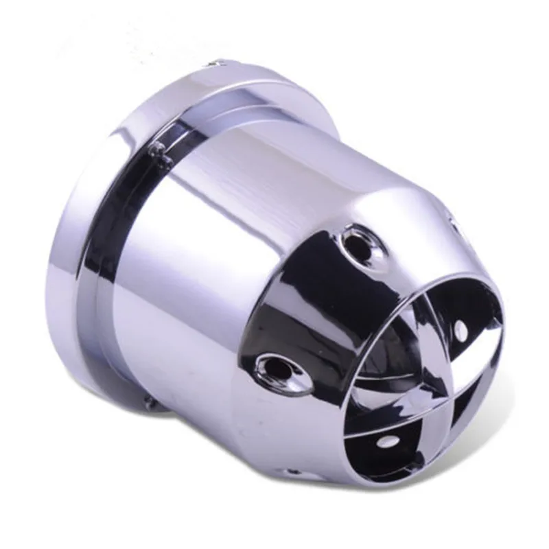

This is the setup I have.
I get about 20 miles on the dusty dirt roads, and this baby is plugged up like a Sumo wrestler on a cheese diet.
(Not that I've ever seen such a thing, I can only imagine)
Anyways, is there a better alternative, or am I just stuck with this air filter problem no matter what?

Do you oil that filter as per manufacturer recomandations?
Look for "outerwears" for it. and or a foam cover.
Also with the fine dust there is something called K&N Air filter grease. IT goes on the rubber boot where the filter clamps to the carb.
8,537
3,625
Are you not using a pre-filter?
A foam outer sleeve? A filter wrap?
Show us a photo of your bike overall and the air filter element after 20 miles of dusty roads.

So yes you oil it, outerwear's help a bunch (my filter was caked in dirt until i got one, the dirt seems to not accumulate as much on the outerwear - so thats the #1 reccomendation from a newbie like me.
Also if its getting plugged up, is it just aesthetics or performance robbing?
Thinking about this hypothetically, the engine only draws in so much air. If you were to spread that same air over more surface area, you get less flow in per square inch of filter, less air flow into filter surface area means less dust into it. E.g. get a filter with more surface area. May not prevent it from plugging up, but will prolong the inevitable. I ended up getting a 5" long and as big around as i could filter for the mini bike and an outerwear to match it. Drove it in all sorts of dust and rain and didnt get much on the outerwear at all. The outerwear has some magical water proofing on it too so you can drive it in the rain no problem.
Also, other engines and air systems use what are called cyclones. cyclones use gravity to filter out the big stuff, and the small stuff that still hangs out in the air makes it through. Cyclones have a cut point though, so if you exceed the flow for what the cyclone is desinged to flow at, you will drag the big stuff through too.

I'm making an educated guess that both of the swirl type precleaners you listed have Donaldson on them somewhere; they work on the velocity of the airflow coming in,and are most commonly sized for the engine's expected operational intake volume at full load. And if you haven't noticed yet, they are usually mounted quite high above the ground to keep them clear of as much crap as possible.
I don't know what one for a small engine goes for, but I'm guessing that it's not in McBudget territory. The best advice I can offer is what I would try using. Remove air filter. Source enough flexible hose to provide smooth airflow between the carb and and a fabricated filter housing; starting with (in this example) a new unused one gallon paint can from either the hardware or auto part's store.
You'll need to fabricate a way to mount the can as well as the connections to mount the air filter inside, then the connection from the lid to a vertical inlet pipe. The taller the better; you need to get the inlet as far away from the ground level dust and debris as you can. Your other machines can give you idea's about how tall.
Ad some form of rain protection to the top of the inlet, and mount the paint can on a slight angle with an ~3/16" to 1/4" drain hole at the lowest point (in case any water does find it's way in), and you should have much less trouble.
And for the record, this is where I would start, based on experience. Have I done it yet? No. But this is where I would start if I had the same problem. And for the record, all of the filtration system advice listed above by the rest of the tribe is still valid, it's just based on trying to deal with it at the carb, which on most of the machines we discuss here have the poor little thing stuck in the worst of the mess.
