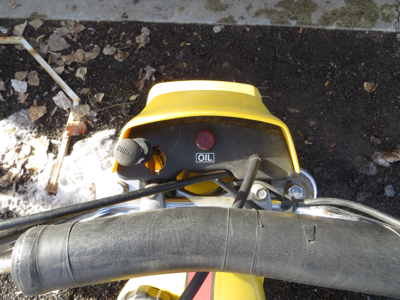

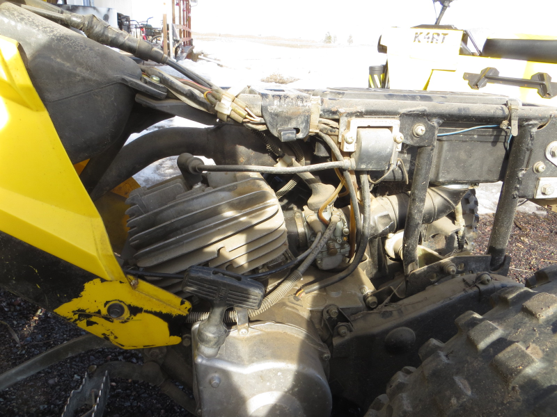

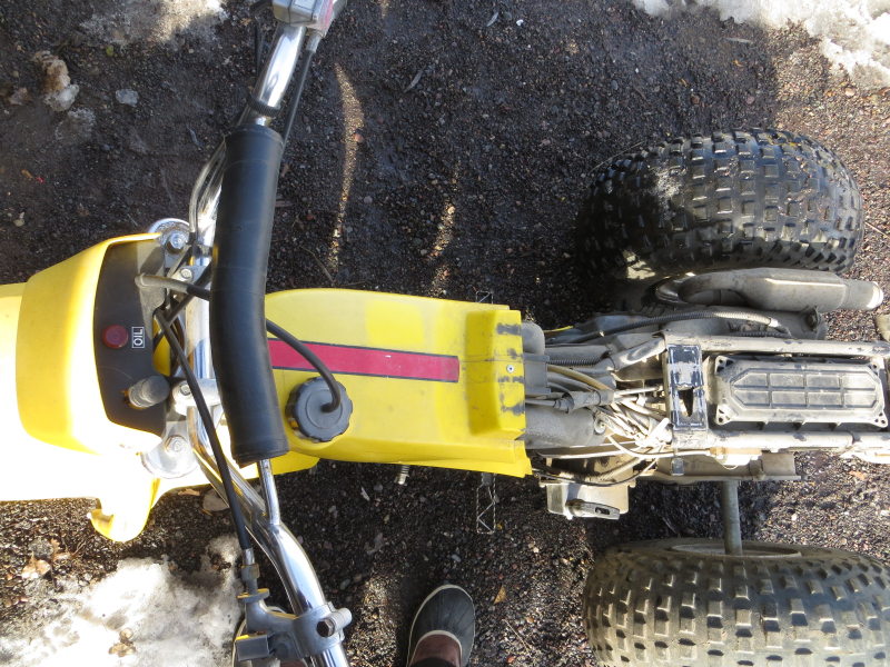

A friend of mine came into town and brought his 3 wheeler he got about a months ago. He got it from a guy that said it was a 2 stroke and needed mix fuel. But looking at it ... Im not sure. it has an oil light indicator and a place to put oil. When I asked him about the oil fill spot he said that he was told it was for the transmission .. But I'm not sure of that. I cant tell. Do these engines have a separation like that? One place for trans oil and then use mix gas? If so what mix would the fuel be ?

On a 2 stroke the transmission is separate from the crankshaft/piston and needs its own oil.
When you mix oil with the gas it is to lubercate the crankshaft bearings, connecting rod bearings, and cylinder.

i don't think thats a honda. it look more like a Yamaha Tri Moto 175 1984 ish. this what a 1986 honda 125 looks like
and what a Yamaha Tri Moto looks like

Quick Tip to tell: 4 Stoke has a Cam or valve cover. 2 stroke doesn't and a 2 stroke has a auxiliary oil tank. Also the muffler is a bit more funnel like than a 4 stroke which is more of a can shape.

awesome info. Yeah after seeing the pics I would say its a Yamaha Tri Moto (yellow). Would you know the mix for the fuel?

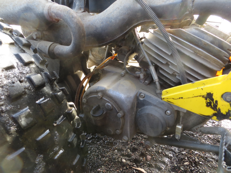

cool . so we could just put in regular fuel from the pump? also the only number on the engine I could find was ... 4U3-011210

I'd go with rocket on this one. Aux oil tanks can be finicky. I run 40:1 straight from the fuel tank on my ATC200s, 2 stroke snowmobiles, and '72 GT550 and '73 GT750. It seems to run a lot better and you don't have to worry about as much maintenance.

Anyways. That's what I'd do. It works out better than factory for what I have and it might for that 125cc. Cleaning the oil tank ain't fun when it comes to it. 6 to 1 really...
