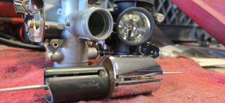

I decided to get the nibbi 28mm.
It was quite a bit bigger. Interior bore was highly polished. The slide was polished. The jets are keihn so easy to get replaced. It came with 2 extra mains and an extra idle jets which was nice. And it's Purdy too!
I have more pics in my thread but here you can see the slide and the bore polish.

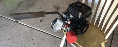

Post a pic of your carb.
