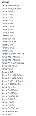

I grew up with one of these! I would like to find another one but haven't had any luck. Would you have any suggestions on where to find one? I have spend hours online and can't come up with anything. Also do you have any information on where I can find some history on Kenbar. I would like to be be able to find all there makes and modes for the karts they have made. Thank you in advance.
