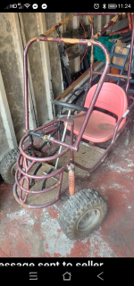

I'm in a similar situation and want to know what the frame ere is also what is the very least hp cc motor I'd need to get this moving at a fun speed, thanks will my 6.5 petrol motor be ok?

Alan I have never seen that style of frame before. I have no idea what they are but cool! Almost reminds me of an old 1/4 midget or sprint cart. 6.5 should be enough to move it at around 35 mph or so depending how you build the engine.
