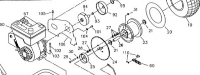

Let's see the whole wheel from the side. I think you might have the old Manco cast metal (some say aluminum) "mag" wheels and for those there was an extra piece, a cast metal stand-off spacer, but I hate assuming. I don't like your long bolts hanging out there, it does not bode well for durability. That's my gut feeling.
I think you might need part #17 from this manual; "8008 Spacer" which (probably) can no longer be found off-the-shelf. Does that sound right?
Edited to add: Here is what the spacer looks like:

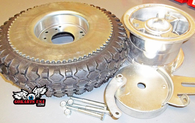

I've been looking up and down for a combination wheel, brake drum and sprocket assembly, ready-to-go, for a dead axle go kart (or minibike) but am coming up short. Does anyone know where to find one that you don't have put together from various parts (and hope it fits)?
EDIT: here's one under the guise of "build a wheel" but I think the sprocket/drum is limited to the Azusa Tri-Star wheel which is kind of pricey, AND it's an internal drum not a band brake (which is far superior IMO).
