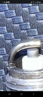

No, no,......ground strap on plug is what I need to see.
Lol. My bad. 🤣 Here are some photos. Spark plug has the threaded portion on it and I’m unsure if I need the adapter for it. Clicks on fine without it. Also added a photo of the old stock coil.
Here's your plug ground strap. I was looking where the change of color is happening on the strap.
I think @Master Hack is on to something about fuel delivery.
