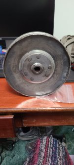

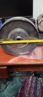

I Broke my jack-shaft and it looks like it damaged the Driven. I thought it was just a 40 Series but Gopowersports is saying it doesn't fit. What is the proper replacement for 5/8 shaft? it has the 10hp Subaru motor.
ptrumblejr
10
10
it sure looks like a standard 40 series

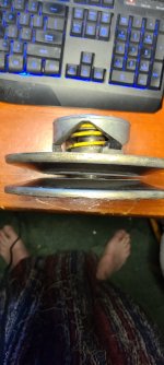

This doesn't look right to me

And yet it is right. It looks as though that clutch was really rusty at one time though and may have some pitted and worn parts in it. Amazon is your cheapest bet for a new one. Also make sure to use a Genuine Comet belt with it. The cheap belts don’t hold up nearly as well as the Comets do! By a factor of over 10-1.
11,596
8,028
Looks like you will need new wear buttons also. Make sure you get the same diameter as the one you have. They come in 6” and 7”.
