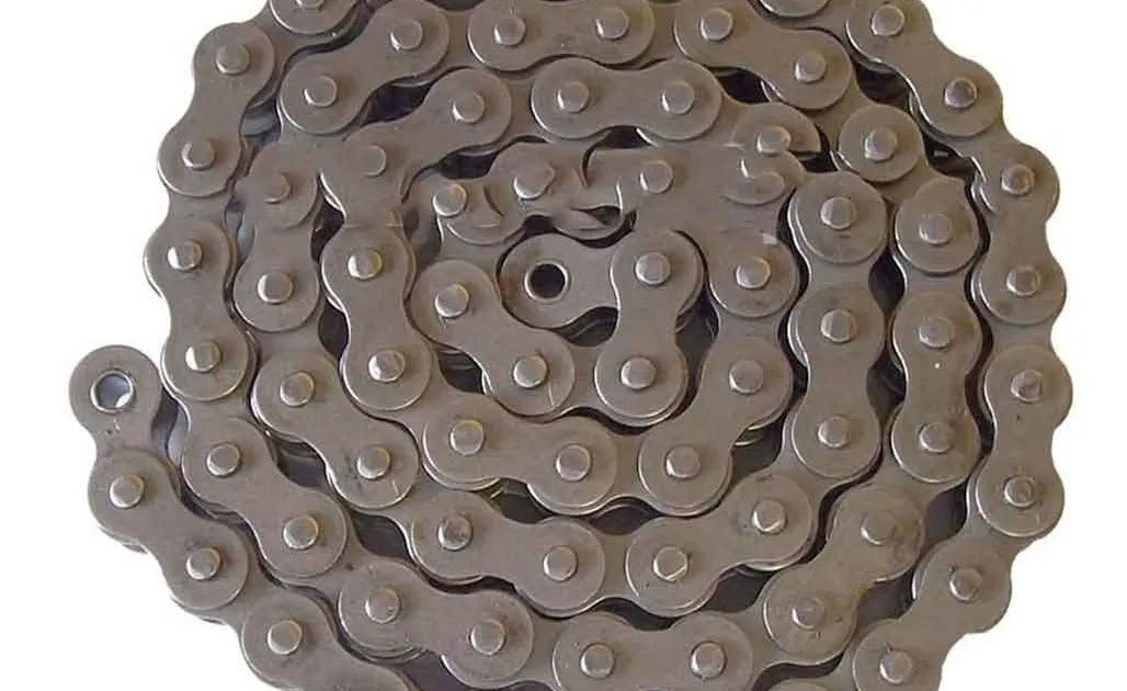

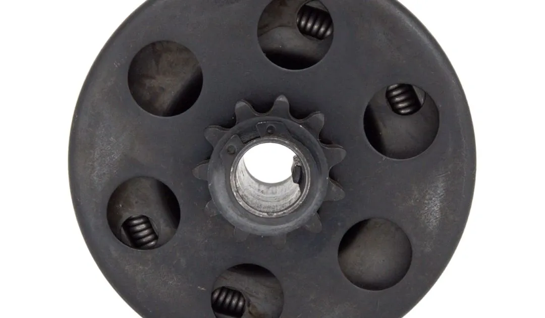

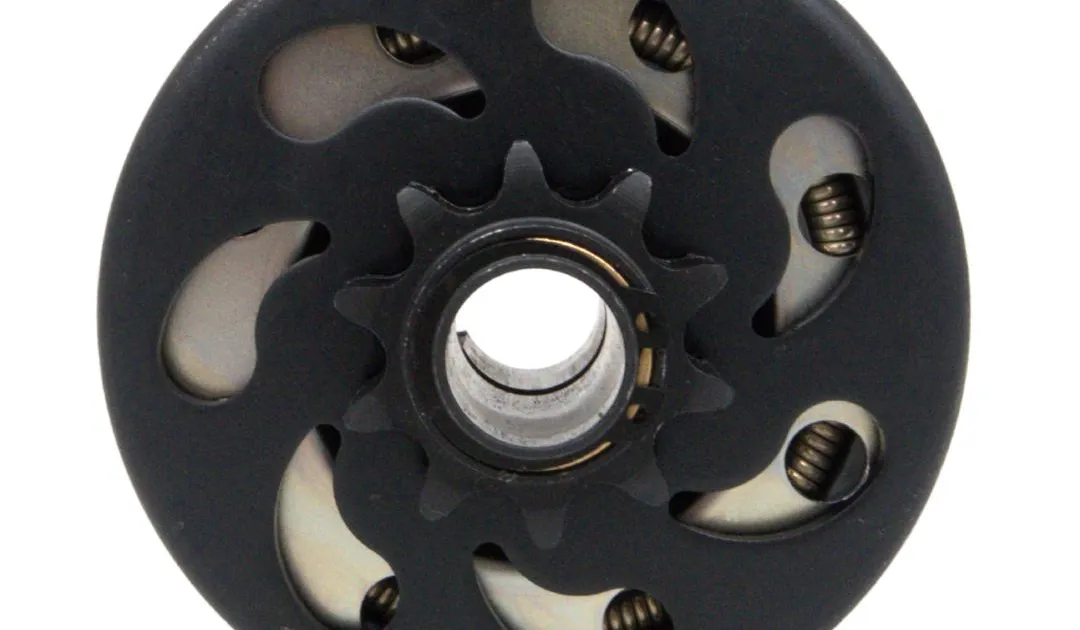

Your chain looks like #35. The clutches you listed are for a much larger chain. (#41/420/40) are much larger links. Those clutches will not work with your chain or your wheel sprocket. That is why I suggested an 84 tooth on the wheel, because 12 tooth is the smallest #35 clutch I know about for a 3/4 inch engine PTO. Replace the clutch, chain and sprocket all at the same time so they break in together.

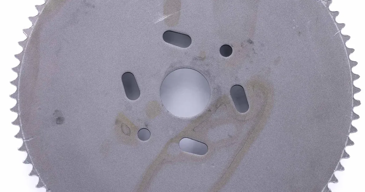

The first thing is getting this sprocket in an 80 tooth option.

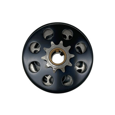

Combine that with this 11T clutch.
And lastly because the chain I have isn't going to be long enough I was going to get a new chain at 3 feet long, maybe 5 feet if 3 isn't not long enough.
I may also pick up a chain breaker to reduce the length and I might need to get a new sprocket hub as well if the one I have won't line up right.

Pull off the sprocket and measure the distance across the holes. Hopefully you can get the 80 tooth to match your hub. Looking at the picture of your existing sprocket it looks like the bolt pattern is quite a bit bigger than the one you are looking at. Worst case, you have to buy a new hub to match. You will not be able to purchase a chain to fit exactly. You will need a chain break tool. The first one I ever bought was their $8 cheapie. I lasted all of one break.Buy a good one. It will last forever. At 7:27 to 1 you should be in good shape with the gear ratio.

Well it used to be an $8 cheapie. Looks like it's the $14 cheapie now. The clutch you posted is for a 5/8" PTO. Make sure yours is not a 3/4". Buy the right one.
