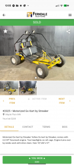

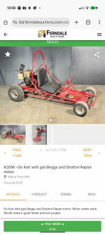

I bought it from an auction across the state. Kinda sight unseen. My buddy picked it up and dropped it off for me this morning. I'm on mids but tomorrow I'm gonna dig into it further!

You got all that for $300?? That‘s the steal of the year! Please update us on that raptor!
Yeah I kind of accidentally bought them. I bid on those two 200 and 100 and then the next day I bought my daughter a CK100 for $100 that ran good but I don't like that one. Then I won these two. So now I have three go-karts. But yeah, here's a picture of that raptor engine. I'm on my way to midnight's but I'm going to dig into him tomorrow.
