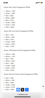

Lower engagement rpm clutch (stall speed) will help.
