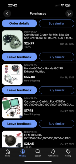

I got the carb on ebay, when I installed it, it only takes 2 pulls for it to start. Works fine
