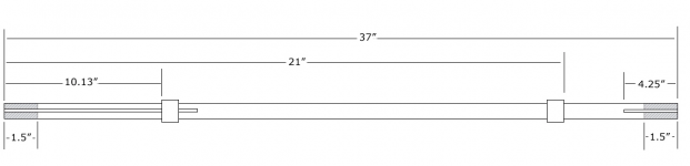

5/8" Diameter Manco Axle 37"​

I think I'm going to save myself a headache and cut the existing axle housing off the cart & install a 1 1/4" axle & pillow blocks.
That way I can use the existing wheels, hubs, & tires
I had put new 5/8" bore brake, sprocket, & axle on the cart so I hate to just set it aside, but maybe I can use it on something else.
