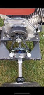

Hello and greetings from Germany,
I built myself a Trike (first project) and after everything is finished I noticed I got a wrong gear ratio (4.4:1; 44:10).
My centrifugal clutch broke twice and now I know that I should‘ve used a 6:1 ratio.
The problem is that I have a #420 44T rear sprocket and I cant upgrade to an 60 teeth sprocket because it would be bigger than my 11“ tire. I can’t change my sprocket on my clutch because it’s already the smallest (10 teeth).
Do you have any experiences with it and could give me some advices so I can get a 6:1 ratio so that my clutch won’t break.
Thanks in advance and have a nice day!
