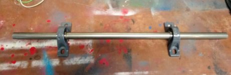

IMG_20210727_190228151.jpgI've picked up bearings and 30" of one inch steel stock. I think this will work out a little better since I can put the engine output and gear on the inside with a new engine plate. I'll cut off the stub axle and weld a couple plates to the frame to mount the bearings. What would you recommend for a gear to solid mount to the axle? The trans has a #40 output gear and I have a #40 roller chain. I'm thinking we'll probably go with one larger disc brake more-or-less centered on the axle rather than 2 on the outside.
