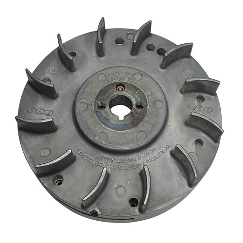

Thanks all for the help. I think I'm gonna give it a try. I still have the stock flywheel. Most of the billet flywheels for the HEMI cost close to whole a new engine and I don't even know how many hours this one has on it.
Plus, since this is a cart and not a mini bike my privates (AKA the home entertainment center) are not in proximity to the engine I thought I'd just wait and see if these stock flywheels actually grenade. I've read many conflicting reports.
The risk is always there. Magnet flying off.

Most of the billet flywheels for the HEMI cost close to whole a new engine…
No need. Plenty of rated flywheels for that engine that aren’t billet (or at ARC billet prices), plus that $26 one off Scamazon rated for 10K 😉
These are just random options, I did not organize according to Hemi or non-Hemi.
