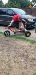

I didn’t see that, where do I find it? I’m in Texas, near Dallas. A friend of mines husband has an old non running gokart frame, with and engine not sure if engine works.
she is trying to get her husband to be ok letting it t🪙go.

So I pulled the car off, cleaned it, fixed the throttle adjustment so it can be adjusted, it was stuck in place from a bend-looked like a rock fell on it. Anyway the carb appears clean, throttle and choke can be adjusted easily now.
if I spray started fluid into the carb it will run for ~10 seconds. When it is running it sounds good, I’m no mechanic but it sounds appropriate. (Mechanic experience is working in a Mercedes’ maintenance shop for a summer and working in small t Max rc cars.
I poured small amount of fuel into the cylinder and same thing, works about 10 seconds then dies- I adjusting throttle and choke with same result.
TLDR
I thunk the carb is not transferring fuel to the engine. The carb bolts directly to the tank.
the piece I’m holding had called off into the tank. I reattached it how it looked like it should go, tried to fire it up. Same result.
I need to attach the rubber tube from the engine to the carb I think it’s an overflow tube? And there is a whole in the top of gas tank that is supposed to be there- Gas comes out of that when starting so I imagine I need to attach something there.
these seem like simple fixes. I enjoy the building problem solving part of this stuff so I don’t mind doing the work; I just need help knowing if I’m doing the right work or just wasting time. I did order a carb on Amazon in case I can’t get this one working.

alrighty heres my specialty, on the side of your carb there is a panel with 4-6 screws, unscrew them and look at the diaphragm and see if it has any tears in it, if it does purchase another from evil bay, if it doesn't take the diaphragm out and blow air or break clean through the jets to push any debris that may be in there, these carbs are a lot of maintenance and can be very finicky
EDIT: that rubber tube is a crank case vent tube and it runs to the carb for pollution reasons, lets also see the "hole" in the gas tank thats supposed to be there
EDIT 2: pull the plastic peice back off that had fallen into the tank and try to blow through it with your mouth, if you cant or its really difficult spray it with brake clean until its easy to blow through
