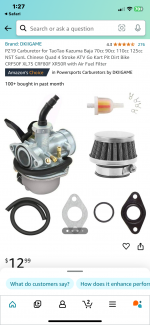

i think I’ve read these pz style carbs are a “bolt on” upgrade. If not an exact fit, I think enlarging bolt holes might do it. I suggest researching “PZ carb on techcumseh” to see if I remember correctly.
it might be worth $13 to give it a try.
