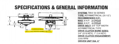

Anyone know where to find the center distances for the driver to driven on a TAV2?
From the TAV2 Comet manual - labeled but no reference dimension.
I am stuck trying to layout TAV2 + FNR gearbox with the 'stock' 27-21/64" (203589A) belt.
Belt lengths will vary with center distances, so I am guessing there is some table somewhere that lists this, but where?
thanks

sinned6915
Thanks Willie1, this is exactly what I am trying to work out. I think that in my case I need to increase my belt length. Finding the belt charts that were eluding me were the key.
I have a Comet FNR gearbox and it's not going to tuck up under my engine as nicely as yours. The input shaft and output shafts are opposite sides of the housing too.
