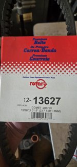

Torque converters are great for karts as long as you use high quality belts. Cheap ones will leave you walking in 10-30 minutes. COMET BELTS ONLY!!!

Have about 6 spare belts hanging up in the garage. 3 of them are comet, one or two them is Rotary ( exactly like the one posted by WTR ) the others don't have the sleeves on them anymore. I usually buy my belts from Go Power Sports. I think the Rotary is their house brand and they sell Comet as well. I have never bought the 3 for $20 cheapies on Amazon. We've broken a few over the years, but it's not like it's an issue. Bike and Baja blaster were purchased new and came so equipped. Yerf Dog used also had one. It came with a 7" driven ( which I didn't even know existed at the time ) as compared to the standard 6". Really makes a difference in the hole shot. I bought 3 or 4 others, all the $59 specials on Amazon. Truthfully, I think they are all made in the same Chinese factory. All parts interchange regardless of origin. Never had any part break. Only problem
