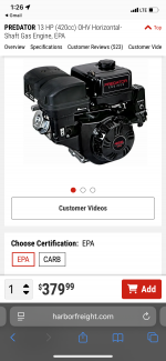

I’m sure I can pick up a predator 420 from my local hobby town…
I’ll have to start researching those gear boxes… $400 sounds like a lot! I wonder if there are many options out there…

I looked at the Predator engine at harbor freight, and a lot of people seem to really like it.
Something to keep in mind is the end user of this particular project...
Regardless of how much I personally might be sold on going bigger or making something custom, this isn't for me. If this isn't fun for a 12 year old girl weighing in at 61#- it won't get used at all and will gather dust.
This kart is their 1st toy like this, so their first experience should be a positive one (and free of a few aspect that the girls would deem nuisances). If they have to use a pull-start, or if they can't put it into reverse, it won't get used. If there is a way to set up a predator engine to have both of these functions, then I'm all in! but... are those normal options for a predator engine?

I really appreciate the encouragement from many experts who encourage me to go the route of getting a predator 420. That much power would be fun, but power and speed is a lower priority... I started doing the math, and the path to taking the predator route would involve a $380 engine, $200ish TC kit on Amazon, $375 F/R gearbox, plus a jackshaft ($100ish?), (totaling over $1,000) and a lot of fabrication for fitment...
This route is $560, will need some wiring (I have the materials for this already), probably a coil, CDI, carb,...($100-ish), combined should be around $600-700ish, and require a lot less fab/customization to get it to fit.
IDK- I might be missing something. I'm definitely a newb to go karts/buggies, so I acknowledge I have a lot to learn!

If you are going to go the GY6 route, fine. But this talk about a 420 predator for your daughters is flat out ridiculous. You don't need anywhere near that much power. All of my karts are big 2 seaters like yours. Two of them are very heavy just like yours. They both use 212, and 224 predators. A $150 predator 212 and a
$60 Amazon 30 series torque converter ( total investment $210 ) will get you about 22 mph completely stock. If you remove the governor you will get 30 mph and the weight of the kart will keep it from going any faster or over revving the engine. Just trying to point out to you how you could be up and running a lot cheaper than all these $500-$800 options. Believe me, the thrill of driving the kart will get them, and they won't know how to steer it in reverse anyway. For your situation the reverse gearbox is a waste of money. Maybe on the the second or third kart with a few years driving experience.
