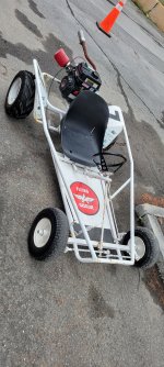

Hi kart peoples, My name is Jeremiah, I'm new here, got a few questions I'm sure you fine humans could help me find the answers to.
1. Bought a kart off the side of the road for a few hundred bucks, have no idea of the frame make or model. Guy I bought it from doesn't know either but claims they make a roll cage for it. Need help identifying it.
2. It goes pretty good but I'd like it to go a little faster. I was told it was stage 2 predator 212 hemi. Without cracking the engine I can tell the governor was removed, the oil sensor is gone, different carb and exhaust. Not sure if they changed anything else such as flywheel or valvesprings. I want to lean towards no on those items as based on a top speed (via GPS) of 31mph I think the springs are floating around 4600 rpm.
3. While I would like it to go faster, kids also want to put out around the yard and fast doesn't agree with the wife for that application. What would be the easiest or simply best way to achieve both if at all possible?
4. The wheels and tires on the kart are 13x5.00-6(from tractor supply) and 16x6-8 (vtred from presumably gopowersports)
Is this a good selection for a kart driven in dirt/gravel/turf/pavement? I've noticed there's not much selection for tires on the rear with same diameter and rim size.
I'm sure I'll think of more questions later but that's all on my brain at the moment.

1. Not sure the make
2. It's probably just a stage one, is the flywheel aluminum?
3. The stock throttle linkage does have a throttle stop screw you could screw in when the kids ride since it looks like you have a stock carb setup.
Those v trees will tear up the turf, but other than that that's not a bad tire setup.

Not sure about the flywheel as I havnt removed anything on the engine. That's under the cover that houses the pull cord right?
There is a throttle stop screw on the engine but wouldn't that burn up the clutch by not allowing it to get to high enough rpm and engage fully? (just realized I don't have a Pic of that side of the engine)

Yes, the flywheel is behind the pull chord. Do some research on the particular clutch you have and find out what rpm it fully engages at. You should be able to limit about half the throttle

Don't limit the throttle with the clutch, it's a really great way to burn it out, or shorten the life. For starters a 30 series TC will make it go. Many people here use the golden combination of a modded 212 and a 30 series. @BrownStainRacing is a wizard with 'em. Once you have a TC limiting the throttle is a good option. Just don't do it in front of the kids, they are smart lil buggers.

For off road use a 30 series torque converter, as suggested by BaconBit is the best thing you could do. Great for put put slow driving, and still plenty of top speed. With a converter you could run taller rear tires. Your 8" rims are the most popular size for off road karts. By a long shot.
