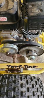

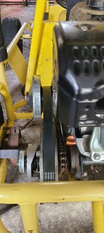

Hello, I just bought a small yerf dog kart and put a predator 212 engine on it. It has a 20 series torque converter, and I just bought the correct comet belt for it and installed it, and when I start the kart the driven just grabs the belt and pulls it. I know I have the correct belt, I used a chart online to find it, and it has plenty of slack. I'm I missing something? The belt also lines up good.
