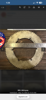

Okay thank you. I’ll go ahead and purchase the tires. I’m posting photos of the sprocket I removed. I’m planning to use a split sprocket for easier installation/removal. I saw some sprockets on GoPowersports. It looks like the shape will fit. I don’t see any specs on the website. Just the tooth numbers. I could call them and get the specs. I’m planning to purchase an identical 72 tooth replacement. In case the tire change doesn’t work out or I wanna keep the original tires. I will need a split sprocket that’s 2 inches smaller in diameter than the one I currently have to be 1 inch higher to the ground. How does the smaller sprocket affect the performance? Faster speed, less torque? Or slower speed, more torque?

I finally have some free time to get back to working on my go kart. I’m gonna go with using a smaller sprocket first. The sprocket that I have now is 8.5 inch in diameter. It sits too close to the ground. If I want to increase my ground clearance by an inch, I would need a sprocket that’s 6.5 inch in diameter right?

Thank you for mentioning that. I will recheck the the ratio using the calculator. But am I right with using a 6.5 diameter sprocket increasing my clearance by an inch? Or will a 7.5 inch diameter sprocket increase my clearance by an inch?
9,145
4,120
A 7.5 inch sprocket is exactly 1 inch smaller than 8.5 inch. The 6.5 is 2 inches smaller (than 8.5). When you measure it, like your photo in post #23, put the ruler directly across the center. Your ruler is placed slightly above the centerline.
Don't forget to count your teeth! I mark the starting point on mine, like with a magic marker (Sharpie) and then count. Then I usually write the tooth count right on the sprocket.

I only have the 8.5 original sprocket. I’m actually just doing some head calculations on what would increase my clearance by an inch. Will using a 7.5 inch diameter sprocket increase my clearance by an inch? Or will a 8.5 inch sprocket increase my clearance by an inch?

I only have the 8.5 original sprocket. I’m actually just doing some head calculations on what would increase my clearance by an inch. Will using a 7.5 inch diameter sprocket increase my clearance by an inch? Or will a 6.5 inch sprocket increase my clearance by an inch?

If yer original sprocket 8.5 and you buy 7.5 your clearance will increase by one half inch. Yer gear ratio will be all honked up. You would need to reduce the drive sprocket by a bunch. The problem is finding one small enough. Sprockets are labled by tooth count.

As long as there’s some ground clearance, and the sprocket isn’t actually rolling on the ground acting like a 3rd wheel, it’ll be fine. I don’t think we addressed what is acceptable clearance or not. You should probably keep in mind that kart tracks are a lot more consistent than your undulating neighborhood street with ripples, dips and patched potholes.
If yer original sprocket 8.5 and you buy 7.5 your clearance will increase by one half inch.…
He’s right. Overlapping the 8.5” and 7.5“ sprockets center to center nets you a mere half inch of clearance. The 7.5” is a half inch smaller all the way around.

Thank you all for confirming my inquiry about the sprocket size and clearance situation. I called GoPowersports about needing a 7.5 inch sprocket but unfortunately their inventory details doesn’t show the diameter of the sprockets, just the tooth count. I currently have a 72 count sprocket and it’s 8.5 inch. What tooth count should I get that would be around 7.5 inch? Attached photo of the type of sprocket I plan to purchase. Thank you!
