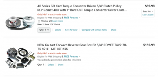

Welcome! And I commend you on the use of a diesel engine. But with the torque that they produce you’ll be better off leaving it a 1” output shaft and stepping up to a 40 series CVT.

I second Denny, 40 series would take the torque no problem, 30 might be in a bit of question. The 40 series is a bit more flexible in terms of mounting as well.

Ok, so instead of taking it to get trimmed to 3/4, I'll just get a keyway, because it's just a threaded shaft. This will help a lot, bring 75$ to a price of $25 maybe...
