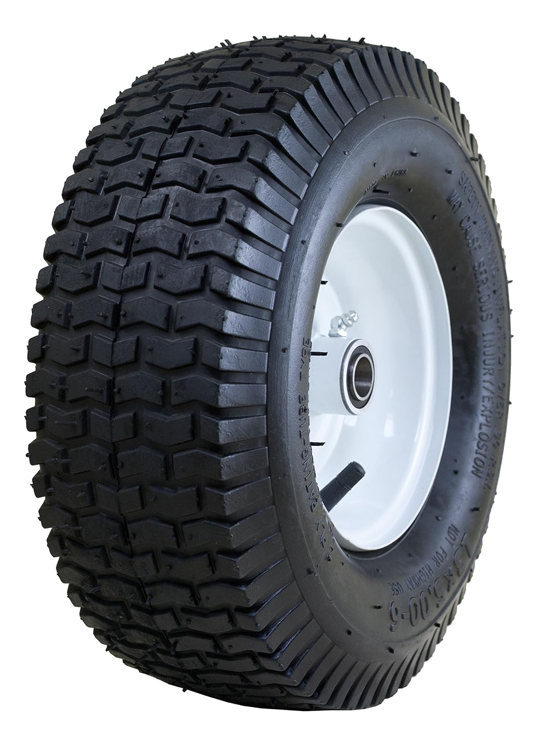

would these do any good?Marathon 13x5.00-6" Pneumatic (Air Filled) Tire on Wheel, 3" Hub, 3/4" Bearings for 25 dollars each
or would these be a better option 145/70-6 for 35$
both include rims
also its a pretty flat gravel road not bumpy or anything clearance is not a huge issue. just really steep

True....but keep in mind...you don't need to go 60 mph on gravel either, sooo, I still think low gearing is the way to go....but...all things are subjective.....
Just like the tires....I can't really speak from experience....but I believe knobbies are awesome for an all around kart..(that never spends too much time in any one scenario) ....but if it were me...I would use the other ones (if the bulk of the driving was on gravel) ...
The wider footprint would provide better traction...and (I think maybe better turning...again....(wider footprint...less chance of just plowing through the gravel)... however, on the front..the knobbies might act a bit like skis and cut a path through the gravel and be better than something that might skid across the top...
Also....not sure I'd want knobbies throwing gravel in my face either.....
