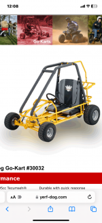

Was anybody able to identify the buggy?
I didn’t have luck.
Single seat buggy with swing arm and engine cage…
Kinda looked like yerfdog, Spider 150, …. But I didn’t find the actual buggy.
so many of these things…
