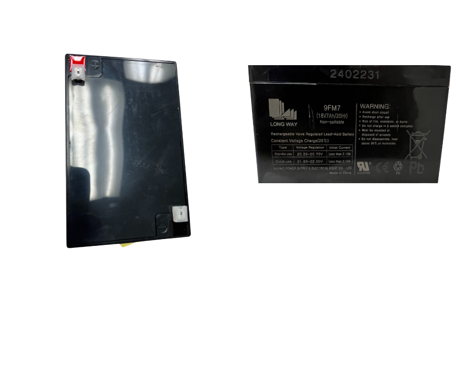

Alright, finally got back to this bike for a coworker. Got the batteries out finally, and I can't seem to find any replacements online other then some stupid bulk buys from Aliexprees and ali baba. Any of you electric experts have any ideas on a replacement or other options?

Dimensions are 6" wide x 4" deep x 3 1/2" height
Are these dimensions (x2)?
I took a looksy around
...& them 18V SLA batteries seem ta be quite the "odd duck(s)" :huh:
Maybe upgrade to a lithium battery pack :thumbsup:
Here are a few options :cheers2:

Thanks FA and WTR. Yes FA, these dimensions are x2. Thanks for the input. Upgrading to Lithium would be a great option! More AH, faster charging and less maintenance compared to lead acid.

Well, after a ton of searching, I found the batteries for $100 each! Only place in the US I have found that has them. :eek:
Told my coworker and he said that ain't bad!!! :ROFLMAO: If it was mine I would upgrade to Lithium, but being this guy doesn't know anything about this, I don't want to deal with it. Waiting to see if he wants to spend the money.

It has 2 18v batteries ran in series, so 36v. It is a 36v system.
I really don't want to modify it if it is his. He is not into this stuff at all. He bought it new for his kid last fall and just wants it to run for him.
