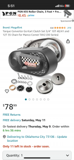

I’m unsure of what’s causing my go kart to smoke…. I have a 224cc engine with a centrifugal clutch with 10 teeth, a drive sprocket with 40teeth, 12” tires, my weight is 165, my go carts weight is approximately 100lbs I put this thing together and it struggles to even get going and soon there after like with in seconds the clutch is sparking and smoking and getting extremely hot
