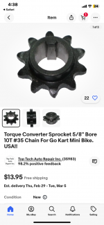

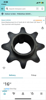

A smaller jackshaft sprocket may be the cheapest and easiest solution to your problems and the change won’t be slight.
I don’t know what the sprocket tooth ratio is currently
But for example, 72T of axle and 12 T on jackshaft is 6 :1.
Swapping a 10 T sprocket instead of of the 12T changes 6 :1 to 7.2 :1.
20% increase in torque.
Or if you currently run 60T : 10T, swapping the 10T to an 8T is a 25% increase in torque. A $15 sprocket swap is the first thing I’d try.
1,864
The TC jackshafts sprockets I use are 5/8 bore.
I think type “C” style sprockets are what I use.
It possible you might need to shorten the key in the jackshaft to use a sprocket with built in key.
An increase of 20-25% TQ is significant.

Yellow spring arrived today. ( from BMI)
I am pretty sure i have a 10 tooth sprocket on the jackshaft
so I will verify the bore size and see if I can order an 8
