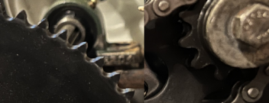

Chain is super rough on start but smooths out at higher speed

What happens if you raise the rear wheels and hand spin the tire. Watch the chain closely. See if it's binding on something or not catching the gear tooth just right.
I watched that video again and I don't see anything obviously wrong.

It looks like the teeth on the big sprocket are wearing funny too

Upadte: I changed to a #40 chain to see if that would help and ineed did not. It was still clunking and I also found that the tension is consitant. For example in one spot it feels solid good tension and then I turn the axel half way and the tension is loose. I tried reajusting everything still nothing im sure something ovious is wrong but I just can't figure it out
Sounds like a bent sprocket IMO. That will cause a "bind" in the chain at certain points.
