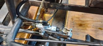

So, I've seen the light, and I bought a hydraulic hand brake and caliper. It seemed like it was really going to work.
However, the banjo connection at the caliper was attached at the totally wrong angle, so I flipped it in order to direct it the right way. Then I lost all braking force, but there was a little pressure build up when I squeezed the handle.
I opened the reservoir to add a little fluid, and now I get zero pressure on the handle. It leads me to think there must be air in the system.
I've tried opening the bleeder and letting a drip out. Squeezing the handle forces it out faster. With the bleeder shut, if I squeeze the handle quickly a shot of fluid flies straight up out of the port nearest the bottom of the photo. I squeezed very slowly a few times, and a couple of the tiniest of microbubbles came out. I've pumped the handle 100+ times, and there is no change in pressure and no indication that any more bubbles want to come out. I've tapped the line up and down. The reservoir is at the highest point in the system, and the caliper at the lowest.
I even opened the bleeder and ran a bunch of fluid out while refilling at the reservoir, and nothing changed.
This was exactly my fear about a hydraulic system. I'm feeling very humbled by this basic system, and I'm completely frustrated. Does anyone have any troubleshooting suggestions or surefire ways to correct this issue?

Lets see how you mounted the caliper.
The bleed screw should be on the top of the caliper.
Getting the air out is a challenge.
Fill the reservoir and pump the master a few times to get some build up. Hold the pressure. Then Crack the bleed screw. A squirt of fluid and hopefully air will come out. Close the screw and re-pump the master. Repeat ad nauseum.
If theres a loop in the line, it can trap air in there and not move enough fluid to push the bubble down the line.
Light pulsing on the master as you were doing is good to get the air out of the master cylinder.

Yes! You nailed it. I didn't pick up on that detail.
I took the caliper off, flipped it over and held it higher. Then I only had to do the pump, hold, release method about 5 times, and it tightened right up. That was terrific. I missed the fact that my bleeder was low, and that was the problem.
Thank you
Now we need a full comparison report and first impressions on the new system.
Hydraulic systems hate air and air will always be found at the high points. That's why ya want the bleeder there. I think everyone makes that mistake once.
