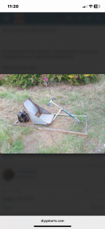

What’s the cheapest braking system if you can fabricate it…
Maybe a “Scrub Brake”?
Not the best option, but GoKarts brakes are often overrated. LOL. I figure if I can turn, stopping is less important. LOL. Kidding… safety is important.IMG_7141.jpeg

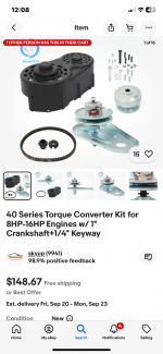

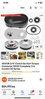

Here are some scribbles and a photo if confused on how a CVT set up goes.
The CVT option only works with the smaller engine because of the budget… I think.
30 series work on 3/4” shaft engines and complete set with that nice backplate are cheap.
40 series are needed with 1”shaft engines and are more expensive. Perhaps prohibiting expensive. I’m not sure $400 works with a $200 400cc engine

Not familiar with this kit…
But similar style kit for a 420cc cost 3x as much
