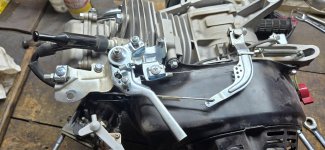

Briggs and Stratton CR950 pressure washer engine for go-kart

I think youre missing the spring that goes from the throttle lever to the governor arm. I think...
You may need to strip away just a tiny bit more insulation on the throttle cable.
Dont forget to adjust the throttle stop after its running. Or remove it.
That’s my new predicament. I’m trying to figure that part out but I’m drawing a blank

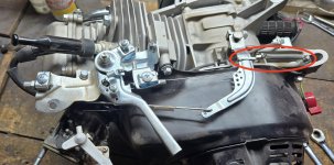

Yeahhbbut what’s this in red? ;)
I think people on fleabay still sell the entire governor and throttle arm assembly (all the light blue galvanized pieces in WTR’s pic) as a take-off or discarded part because they think it’s not suitable for vehicle use. They buy these instead:
