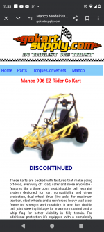

I acquired this manco go kart bought a 224cc predator motor and put on it it has the stock cog on the driveshaft I was wondering what clutch would be best for sand small hills and dirt bigger family I personally weigh 300 but my kids are 125 140 what would you all recommend once again everything is stock but the engine I bought thanks

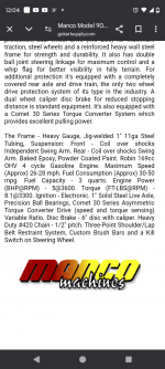

Did you bother to read your own post? Right there in the text it states that the kart is equipped with a 30 series torque converter. Also known as a cvt. That is exactly what you need. Especially for use in sand or hills. It works like an automatic transmission, low gear ratio for hills and sand, higher gear ratio for cruising on level ground. The ones you find on Amazon for about $75 work fine. They're all made in China, so don't worry too much about one brand over the other.

Well technically the 30 CVT Torq-A-Verter IS a clutch. It has a clutch in it and then variable diameter pulley sheaves that create different gear ratios based on centrifugal forces, similar to a centrifugal clutch. Blah blah blah.
Manco 906 EZ Rider go kart. Could be any of these manuals but it will show you what other parts may be missing and what should be there....
