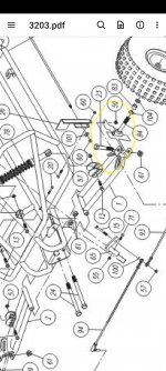

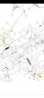

Yup, looks like I have the 3200 series and Panchothedog has the 3203. They definitely learned what to do better on the 3203. Oh and I didn't circle it but you can see the Pittman arm is flipped on the 3203 vs the 3200. Such seemingly small but important updates.
