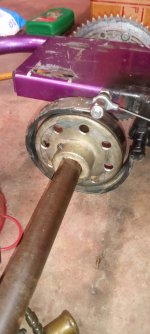

On the kart that I just sold, the band brake worked well cold but stopping diminished quite a bit when hot. Has anyone tried to drill holes around the drum flange and install some perhaps 3/8"x1" bolts to add mass and to hang out, cooling in the breeze? Or added any cooling to them at all?

You’d be the first, around here anyway, to drill a band brake and drum. DO IT.

The added mass may just absorb and retain the heat. A slice of this on the band would be interesting:

True. The old live axle kart that I posted a photo with my daughter sitting in it, never had any brakes!!

Looks fabulous.
Keep going, keep going. 🛠️⛏️ I think JimD (Max-Torque) showed a completely honeycombed (drilled out) clutch bell on one of his videos. Not for cooling but to reduce the rotating mass and allow quicker engagement, I think. Anyway, that’s what your brake drum reminded me of.
