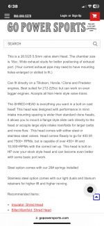

So had my arc 1.3 ratio rockers on the exhaust side fail on me. Luckily it was just while at low rpm. Nothing else went wrong just the rocker. Is this a known issue with them?
I'm running a dyno 308 cam, chromoly pushrods, arc rod, arc flywheel, flat top piston, shred head, 5.5 stainless valves +.150, 18lb valve springs, aluminum dual valve springs retainers.
Pushrod length was adjusted and showed the roller contacting the middle of the valve where it should be. Lash was at .003.
I want to use arc rockers again but now I'm worried this is a common thing with these. Anyone know for sure?

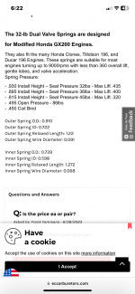

Also you were right about the valve springs. I am running 32lb dual valve springs. I have no idea where 18lb came from.

Have never used the E C rockers. Just went on their website. They look great. A shaft mounted roller fulcrum and a roller tip. Look almost identical to the Gage rockers. I wouldn't hesitate for a second to use them. I'm sure you'd be happy with them. Yeah, 32lb. sounds more reasonable with that cam.

I don’t know enough about your head.
.400 seems like a lot of lift on the exhaust side.
32 lb spring (with 0.895” install height) should allow .400” lift. Seems like the pockets were cut wider and deeper to get proper installed height.
No clue on piston to valve clearance in your engine.
GPS description says it is set up for 0.400 lift so I assume it is just a part failure?
Maybe just double check the installed spring height next time.IMG_7063.pngIMG_7064.png
