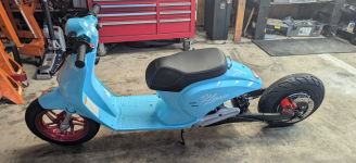

Built about 6 now and every time they get faster and faster. Latest is this tiny kids pocket mod razor scooter.
Has an average QS212 5kw 10” hub motor.
Use LIPO RC batteries for super high amp draw and tiny packaging. This one is 117v at 400 amps.
A 961000 Fardriver controller to dial in the power progressively.
Thats about it!
I’m 220’bs and 6’4 so far from the ideal jockey on a mini bike.
On a pretty poor surface this things going a 3.4 sec 0-60 and a 7.5 sec 1/8th mile at 87mph!
Using a Draggy performance meter for accurate data recording.

Don't have ano other videos as I'm the only one filming, lol. Have a few pictures.
Basically was a $100 kids bike new in box from market place.
$80 steel swing arm and an idea...
