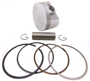

On Facebook they thought this was made with a piston from a 2 cycle boat engine.
My statement remains, and would have to agree despite that being a flathead lid behind it. I've never seen rings positioned so low on ANYTHING that they crossed over the gudgeon hole... I suppose it's as good of a way as any to wet the oil ring set though.
I decided against using the dished piston primarily because the top ring is only 5mm down, I'm not willing to weaken the top land and risk the level of catastrophic failure likely to occur.
That piston is gas ported, note the holes around the crown. They go to ports behind the rings. When the cylinder fires the hot gasses go through those ports and push against the back side of the rings and push the rings tighter to the cylinder wall. Weird, because pop up pistons don’t play well with flat head engines.
