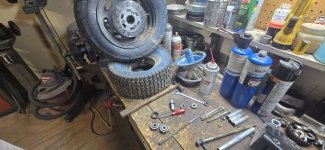

Brought this home for some reason. I think I felt bad for it sitting in the junk pile of some yard.
Put it on the healing rack like I've done a few times before.
Cut and remove the methhead repairs, so to speak, is the plan for now. Im not gonna assume. But he sure jumped at a few $20s
I took some pics of all this stuff, but I'll entertain you with a video. No script so excuse the rambling.
If any of yous guys recognize anything I'd appreciate the info.

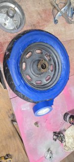

I will give you guys a look at how I found some of the stuff before I removed it.
These were the highlights.

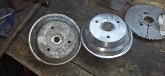

I thought I had a sprotor. Na its just sitting there.

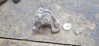

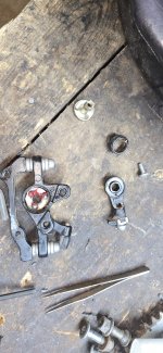

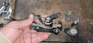

Front brake was the same. Not sure how this was gonna ever work.
