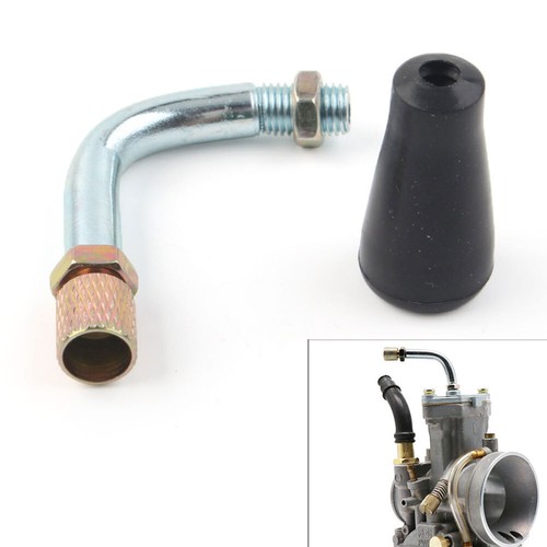

I typically do not have a problem with kinked cables in my go kart and minibike misadventures because I make sure I have and use enough cable and sheath to prevent kinking. However, I will readily admit that the arc required for smooth operation from the straight run along the frame rails to where it (radically) changes direction to the engine can often make the cable poke outside the boundaries of the kart or bike, making it vulnerable to damage.
So your statement:
it has this big old loop that goes around so it can feed into the engine from the side. This causes two problems. It tends to kink, which isn't good.
...is incorrect in my experience. You need that big old loop but don't make it too big of course. Using the absolute minimum length of cable to connect a throttle that operates perpendicular to the cable run will cause the cable to bind and kink on the corner(s).
What I would suggest to retain the closed environment of the cable and its sheath is to use a throttle cable elbow. They're available in a myriad range of sizes and configurations and you could probably make your own with a tubing bender (and some dies because threads are nice)....

I have not heard of this until now. Thanks for the education.
So your statement:
That's cheating. Didn't know they made such a thing.
9,238
4,213
I know right? Have seen them on myriad vehicles and maybe some machinery(?) but really never said "hey I need one of those"
They are seen on a lot of the newer glut of Chinese cages with wheels ("go karts") where the throttle cable pulls from the rear of the engine and curves under it courtesy of a 90° elbow.
