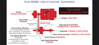

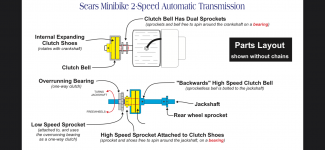

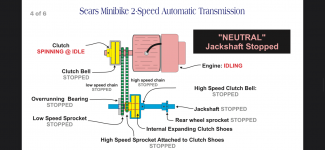

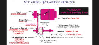

Cool stuff. And this reminded me that I wanted to ask about a specific type of bearing. They used to sell 2-speed automatic “transmissions” for minibikes using 2 clutches and one sprag / one-way / over running sprocket.
Are there any cheap solutions for someone who can’t machine to find a sprocket carrier with oneway bearings inside? When I looked before, it seemed like “hub” needed for the size and HP required for karting, costs way too much.
The finished “one-way clutch” would probably be something like 5/8 or 3/4 shaft, #420 chain, maybe 20T on the sprocket? Rated for 15-20 HP… Freewheels in one direction. I don’t really know how many teeth it would need. I’m too tired to math. Really just looking for the “hub” that I could attach a sprocket to.
