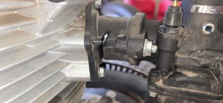

Hello I’m a grandad trying to provide some fun for my kiddos and having some issues with a gokart I bought used. Can you guys give me some wisdom?
Taotao GK110 Gokart
The original carb was plugged solid and was riveted together, so I purchased a carb on Amazon. It fired right up after install, and the kids road it for several days with no problems at all.
it began to run rough and bog down on acceleration. I tried new fuel, new spark plug and adjusted the air mixture and idle on the carb. Adjustments did not help an engine. RPMs would increase on their own when sitting at idle.
I purchased an OEM carb. Again it fired right up. Road it for a few minutes and it did decent but was running a bit rough. Once the engine warmed up, it really started to spit and sputter and stumble on acceleration and occasional backfire. Adjusted carb numerous times in small increments and nothing helped.
I’m not familiar with these Taotao’s but have rebuilt and adjusted carbs on my tractors, mowers and welders.
at this point, I’m thinking it’s not a carb problem. What else could it be?
